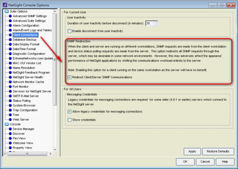

Thank you sir, I knew this way already.
But it does not recommend by Extreme, so I didn't update the issue.
The NIC setting file was located as following path,
"/etc/network/interfaces"
After add the 2nd NIC,
NetSight need to modify something to make those devices on 2nd NIC can be searched with interface summary, compass.
Update the issue for you~
