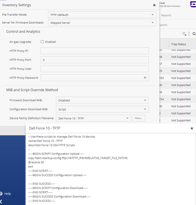

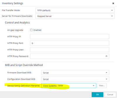

Thank you. We have now managed to log into our XIQ-SE using WinSCP and navigated into the correct folder. However, when we have copied the new script file into the folder, we the dont see it in the Invertory Setting -> Device Family Definition Finename. What is the reason for this ?
The new script should show immediately in the list you highlighted as long as the 'name' i.e. name="Dell Force 10 - TFTP" in the script is unique.
