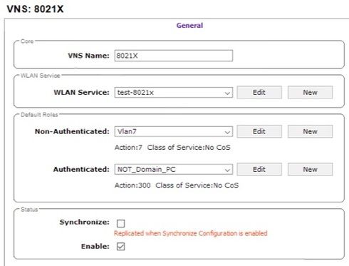

Anyway, I tried my best and deleted all custom made CoS and Roles on the EWC, then enforced domain policies from Netsight successfully. Then I configured the VNS as below:

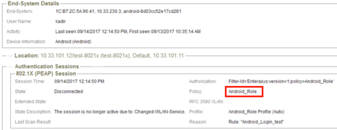

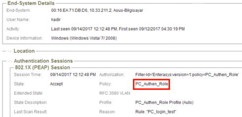

Then, I tested this configuration by connecting two different clients to the same SSID (test-8021x) simultaneously: one of the clients assigned to "Vlan211" and the other assigned to "Vlan311" which are not related to "NOT_Domain_PC" role. They are just assigned to Vlans that NAC sends as radius attributes :
Test client-1 Authentication session:
Test client-2 Authentication session:
I understand from this test that no matter what is chosen in the "Default Roles >> Authenticated" field, clients are assigned according to radius attribute that NAC sends.
Is it right ?
