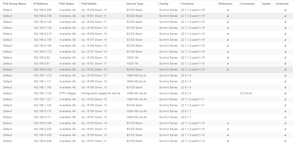

XMC 8.4.3: in our device groups for core server switches one of the switches has poll status “ZTP+ staged” and poll details “Configuration staged for device.” Additionally as firmware version an older version is shown.

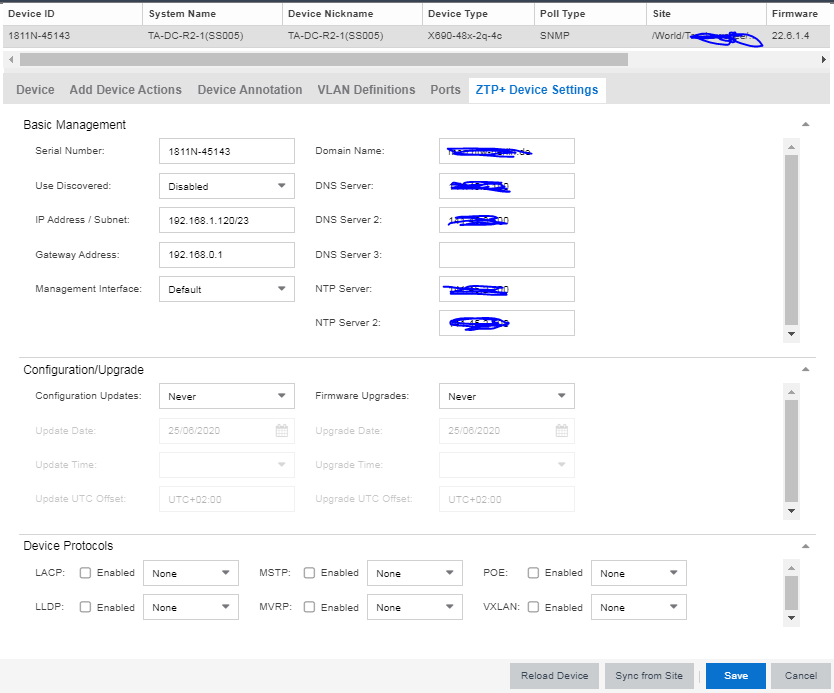

If I do a “rediscover” for this device, the actual running firmwareversion is shown (22.7.1.2) for some seconds, then the table view switches back to firmware 22.6.2.4, which was used two switch updates ago. “Configure device” shows a ZTP+ tab, where configuration and firmware updates are disabled:
How can I disable ZTP+ for this device?
