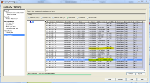

I need to verify that it is an accurate report and understand how a singe device can have too different dates in the date field.
According to "Help" Date = The date and time of the data sample used to generate the port information.
