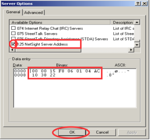

If your new switch has EXOS v15.7.1 you can take advantage of Zero-Touch Provisioning Option 125.
When a switch with v15.7 boots up in factory default it will request an IP address using DHCP. This will be done alternatively through the mgmt port and any connected port in the default vlan.
You should program your DHCP server to send back Option 125 with the address of the NetSight server.
Option 125 should contain the following:
0x00 0x00 0x15 0xf8 0x06 0x01 0x04 and then the IP address of the server.
So if your server has an IP address of 172.16.56.34, dof example, the string returned by Option 125 should be:
0x00 0x00 0x15 0xf8 0x06 0x01 0x04 0xac 0x10 0x38 0x22
When the switch starts and receives an IP address and Option 125 it will send a SNMP trap to the NetSight server. The NetSight server will show this newly discovered switch in OneView -> Devices -> Discoverd
Then you can right-click on it and select Load Configuration
This will open a window that will let you upgrade its firmware and download a configuration
