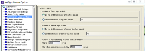

I think it's this setting in the of Netsight Console options menu...
Number of Rows to keep in Event and Alarm table
4c8c8d640d404242addefa97df8bf548_RackMultipart20150728-22220-4r23wt-Netsight_alarmtable_inline.png
Just click on help in the lower/right to get the explanation for it.
In short...
Clip to nnnn rows
This value sets the number of rows that will remain in the table when the clip limit is exceeded.
Clip when above is exceeded by nnnn rows
This value, added to the Clip to nnnn rows setting determines when the table will be clipped (trimmed to the value of Clip to nnnn rows).
