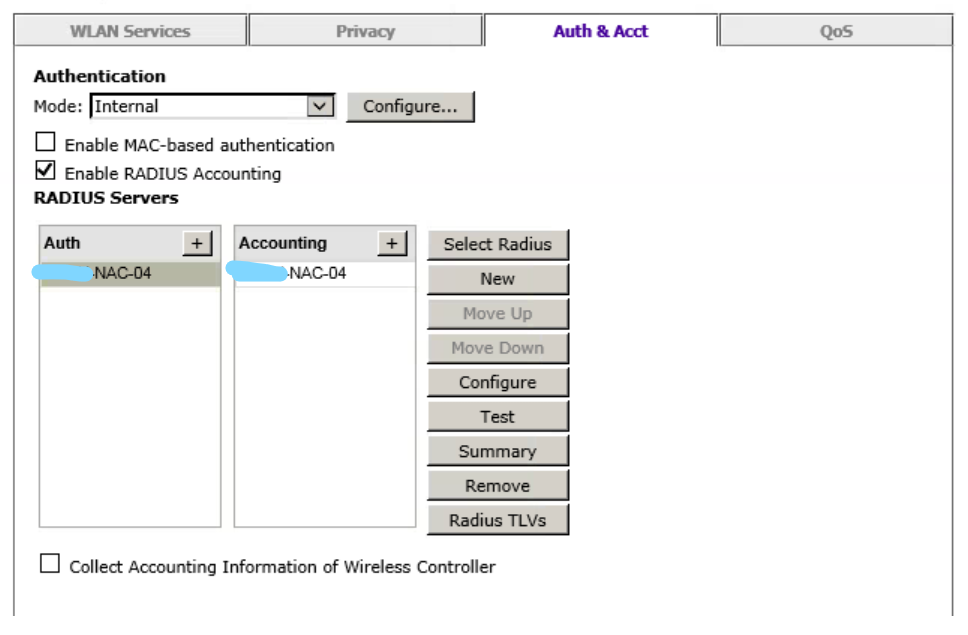

Have configured an internal captive portal on the EWC with the following authentication settings:
Whenever I try to use the ‘Test’ function with an AD account I know is valid, I get the below:

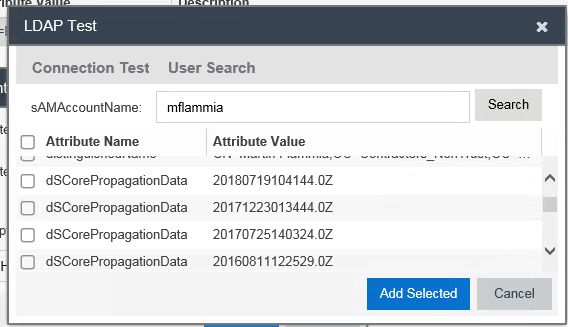

It seems to be failing evaluating the username against the LDAP user group ‘AD_Users’. If I evaluate that same username against the same user group in NAC it passes fine:

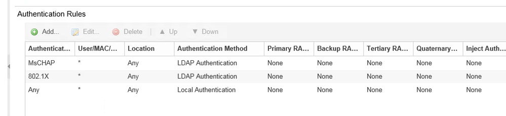

Managed to work this out.
I incorrectly set the AAA authentication rule with an authentication type of 802.1x, the answer was showing in the logs above where it needed to set to MsChap, see below where I added eh MsChap rule:
After this it then worked.
