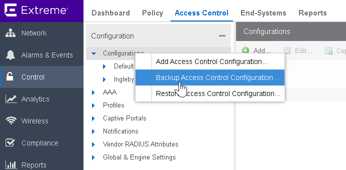

The configuration of NAC is backed up as part of the XMC DB, equally you can take a direct backup as follows:
Control → Configurations (and right click)
