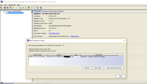

When looking at the NAC end-system licensing / capacity there seems to be a contradiction in the figures, but that could be a misunderstanding in my interpretation? Take the example below, where 500 end-system license are included in the NMS-ADV, and the customer has purchased a further 1000 - that should give a total of 1500.
The problem is the 'Total End-System License Limit:' says 1500 (in the pop-up window) but the 'End-System capacity:' shows 1000 (Under Configuration tab)?
I would expect the capacity and limit to be the same based on the total amount of end-systems licensed? The capacity currently shows that it is 235% over subscribed, but really that should be less based on the bigger limit - which therefor is used to baseline a license breach, capacity or limit?

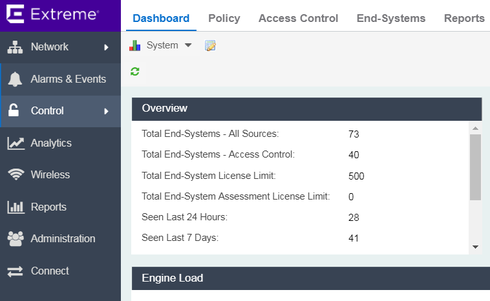

‎03-01-2018 01:11 PM
Guys,
Is there any way to read what is the total end-system count, limited by all applied ES licenses ?

You'd see it in EMC, here the GUI page with the "Total End-System License Limit"... 500 in my case.
