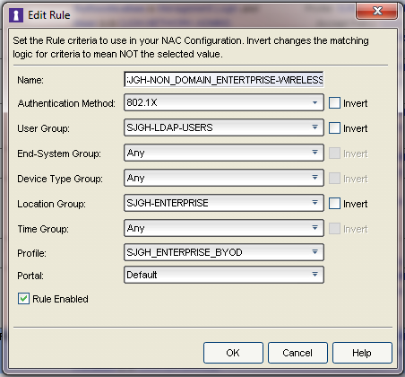

The rule is set as follows:
Authentication method: 802.1x
User group: LDAP-USERS
End-system group: Any
Device Type Group: Any
Location group: ENTERPRISE (this is the name of the VNS on the controller)
Time group: Any
Profile: ENTERPRISE_BYOD
Portal: Default
f51efe35a52245a198c8711224d0cf77_RackMultipart20161028-51278-8fo41o-nac-rule_inline.png
This works perfectly with our old controller. The users authenticate via 802.1x, LDAP lookup works, they come back and hit the right rule on the NAC and the correct role is returned to the controller.
However, with this same setup in the NAC for the C35, it does not correctly identify the location group and the rule fails, thus returning the default profile rather than ENTERPRISE_BYOD which is what we want.

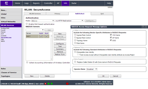

Ronald_Dvorak
Honored Contributor
just to make sure... the SSID on the C35 is named "SJGH" and not "SJGH-ENTERPRISE" because the location is set to "SJGH" as far as I'd see it from the screenshot.
Ronald_Dvorak
Honored Contributor
OK, in the controller on the Wirless Services click on the NAC that you've selected (NAC1 in my case - the field changes to gray) and then you'd click on RADIUS TLVs to configure which additional information the controller should send in the RADIUS request.
Normaly I choose VNS Name, AP Name, SSID but you'd check what is set on the 4110 pair.
Here my example...
0ddd6c5164874b30b8dbf79b175be4a4_RackMultipart20161031-61519-jdodzb-EWC_RADIUS_TLVs_inline.png
