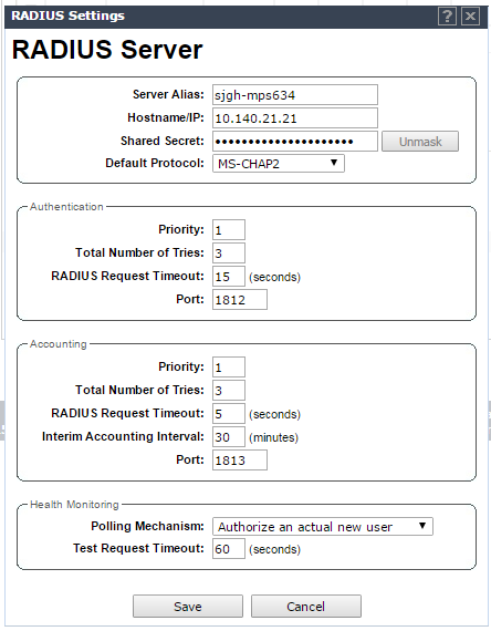

Bill_Handler
Contributor III
Scott,
Can you double-check the RADIUS set up on your C35 and post a screenshot? There was a bug in v10 of the wireless firmware so when adding a controller, the RADIUS server info was corrupted. Just want to make sure that did not bite you.
Sure, here you go. Radius from the old controller:
8eee417a571f4d739c19139f0244b1c1_RackMultipart20161031-60506-1ogxzmu-radius-old_inline.png
And radius from the new controller:
8eee417a571f4d739c19139f0244b1c1_RackMultipart20161031-6694-zf9q0x-Radius-new_inline.png
