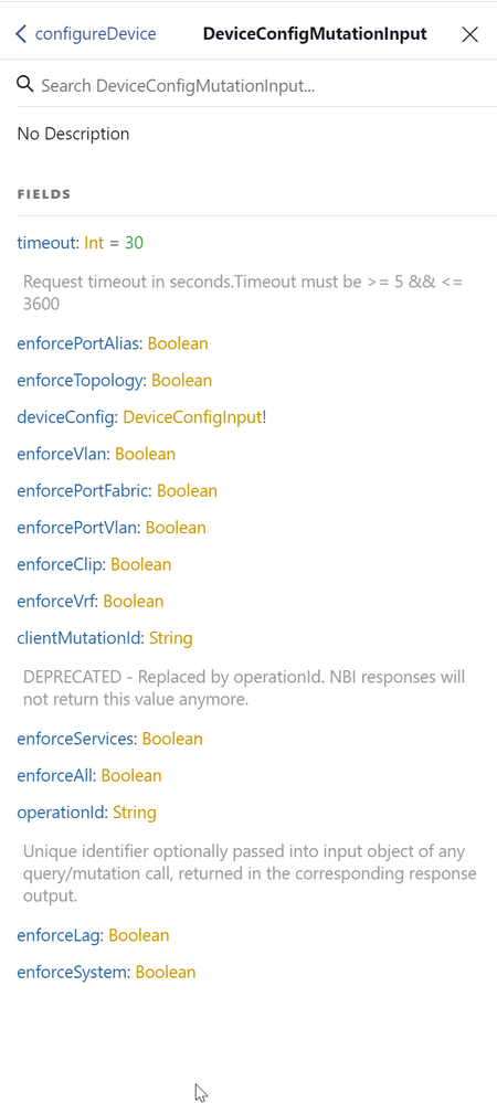

However, there is a call (mutation { network { configureDevice}) that does this.
Regards Stephan
