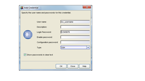

To use Command Script Tool is necessary to configure a username and password in NetSight Authorization/Device Access and Profiles/Credentials-->CLI Credentials.
How can I to hidden my password on CLI Credentials to that another person don't see it?

I think you could disable the feature "Show Passwords in Clear Text" for all of your user groups. Then you would also have to figure out how to make it so that nobody else can turn on this feature, i.e. you have to play with the settings under Authorization/Device Access to get what you are looking for.
When I need to use this feature I use my username and password for the CLI config. Then I go in and change it to something else when I am done. Not ideal because another admin can see my stuff while I am doing the work but at least that way I minimize my exposure.
