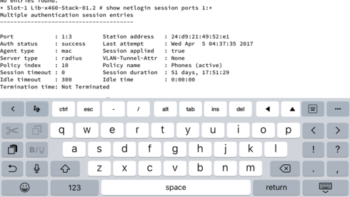

can you run show netlogin session port... The command is similar to that but will show the status of the device.

Thanks, Jeremy...
I think "configure netlogin port 1:36 authentication mode optional" isn't enough... Should it be some more configuration strings? I think, it must.
