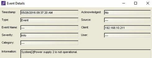

What he have found however is that if a Redundant power supply in a chassis looses power a syslog entry is logged as "Informational" in Netsight. This does not raise any alarm on the device en subsequently no email notification is sent. (None of the predefined alarms is matched to action anything)
We have to create a custom Alarm for this.
The Syslog Entry looks as follows:

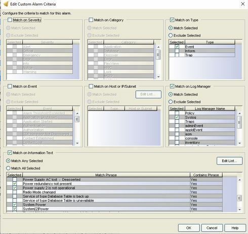

I have created the following custom Alarm to much the above syslog entry:

Weird, looks OK to me, could you check some basic things..
- date/time, is it correct on both Netsight and the switch
- email - do you get an mail if you click the email test button (in Action, left button from the pull-down where you've set it to "Andre"
- could you add another trigger message - try only "Power" - just to make sure that it's not working because of the (2)
- in Actions is "Alarm Suppression" disabled

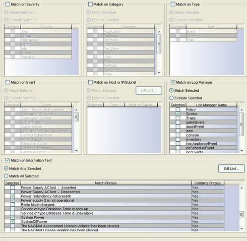

I have tried removing the "Match on Type" I only have the following now:
Still not going 😢
