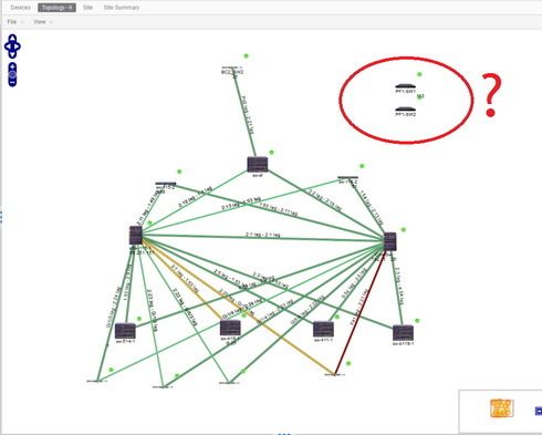

Here is my map:
Please, let me know how may I solve the issue?
Many thanks in advance, Ilya
