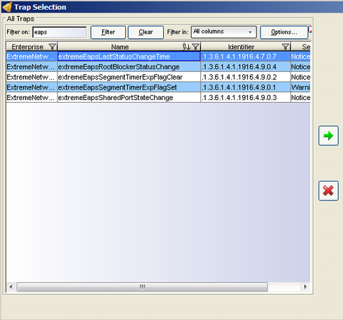

Where did you select this traps? In Netsight 7.0 there are ony traps with word "eaps' in as shown in image.
3cf8b8c7389a48ceb7316c76eaf47cb6_RackMultipart20160805-56571-kejjag-eaps-netsight_inline.png
And when I selected extremeEapsLastStatusChangeTime alarms goes wrong, it send message Ring down when it goes up. Or in 6.3 it was working and 7.0 aint?
