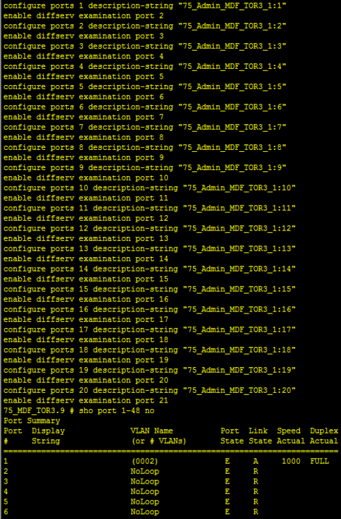

I recently found that when changing the sysName through Netsight it configures the old sysName as a display string on all ports that did not previously have a display string configured.

‎03-17-2017 03:10 PM
Found another related oddity....
