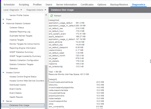

Just thought I add this to help show whats being used up in the database and where, go to
Administration -> Diagnostics
set the diagnostics level to 'diagnostic' and proceed to
server -> Database Disk Usage
As you can see below it shows exactly how much space is being used, and for what reason:
d5258311b0984da9a4cf35eb2d229506_RackMultipart20171001-44108-s1xrnt-DB_Usage_inline.png

Thanks Mike. I ended up setting the data persistence to 1 day. Set the time for a few minutes later, then set the persistence back to 30, and now the rpt file has gone down to 2.4Gb - so you where right on the money with it being NAC.
Appreciate the info.
