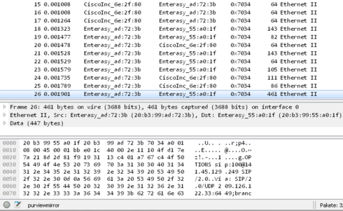

This is a wireshark trace directly from the n-mirror port:
a1d7b2b81a8344e3b065fe8f0f9024e4_RackMultipart20161108-55662-98lmcc-wireshark_inline.png
F.e. we see a paket here which has something to to with SIP. We also see the 0800 ethertype at byte 16 and 17 but it is at the wrong postion. Shouldnt it be at byte 12-13? I dont know where 70 34 and a0 01 do come from. They are in every packet.

Ethertype 0800 or 8100 (for tagged) is always at byte 16 and 17 in the captures.
