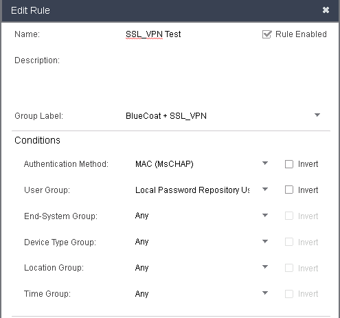

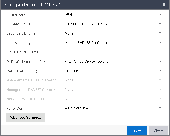

Basically have Cisco ASA configured in NAC as per below.. Had the Switch type set to ‘Layer 2 Out-Of-Band’ but also ‘VPN’ as per below.
The ASA is authenticating VPN access requests via the NAC

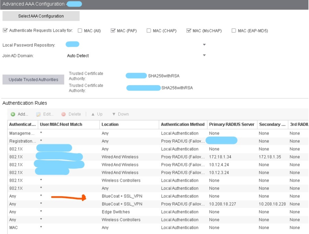

The image above shows the authentication rule in question with the red arrow. The location has the IP address of 10.110.3.244, which matches the source NAS from the captures below. Wasn’t too sure  what to set the authentication type to, so just left to ‘Any’ for now.
The local database has been configured with a different name then ‘Default’, and the account ‘mflammia’ created.

It seems the reason is the authentication is skipping over the rules and hitting the end,
To keep it simple I’ve also created the following rule, but still seems to skip over it to unregistered rule even though the authentication type MsChap and username mflammia match local repository?

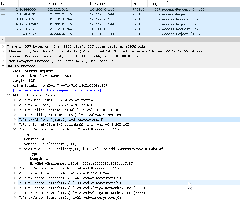

The Calling-Station ID is an IP address, and the NAS Port-Type is Virtual, as in the logs below.

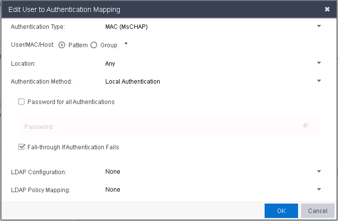

Also made a change to the auth mapping to make it more simple:

processRequest: rejecting request because: RADIUS client not standards-compliant. Missing attributes: End-System MAC Address
Command: Reject User(0x23), Version: NAC Version 6.2.0(10), Reject Reason: RADIUS client not standards-compliant. Missing attributes: End-System MAC Address
getNacResponse for MAC: 00-00-00-00-00-00 => NAC AAA Response [ID:531, Command: Reject User(0x23), Version: NAC Version 6.2.0(10), Reject Reason: RADIUS client not standards-compliant. Missing attributes: End-System MAC Address
 This is not an administrative request due to MAC: null, username: mflammia, MS-CHAP-Challenge Present, Tunnel-Client-Endpoint Present, NAS-Port-Type: 5
The ASA is passing username and password, which should be authenticating using the local password repository on NAC. The NAS Port-type is set to virtual, so why is it enforcing a MAC address?
