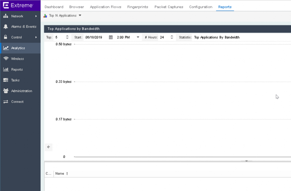

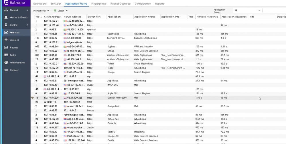

I probably just missing something obvious, but I currently have Netflow data from dual wireless controllers sending data direct to XMC, as there is no Analytics server.
I can see the flow data is coming in, as per below:
The problem I have is the Top users & Applications reports keep coming up blank?
I thought rightly or wrongly you don't need analytics to show this information, that correct, or maybe something that was capable a long time ago?
Maybe there is something additionally I need to configure?
I played around with adding the NetSight server itself as an Anaytics engine, that wouldn't work but the reports would then give me a drop down for two of the same thing. Neither showed the reports though. Now removed it, and although I don't get the option to select the server my assumption is that it just defaults to 'NetSight Server'?
XMC is running version 8.2.6.5
Wireless is running 10.41.09.0008
Many thanks in advance

Top applications are seen and identified by the analytics engine. So you would need that. I believe that then ties to NAC/Control for the users.
