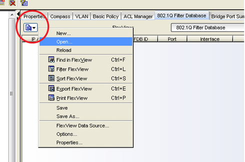

I post a picture just to show where I am at a deadlock(((

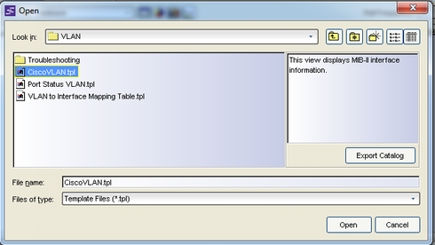

Netsight has a FlexView for Cisco VLANs. If you open the FlexView Database, and navigate to VLAN, there's a CiscoVLAN.tpl FlexView.

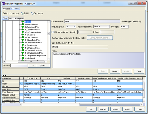

And while it returns mostly interface information, If you select Properties from the menu I showed in the first screenshot, you can edit it and add your own OIDs like Mike previously mentioned, OR, you could create an entirely new FlexView
