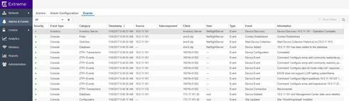

I also checked the event log. It seems that the script is not executed at all. Neither CLI nore JSON-RPC.
regards
Alex
