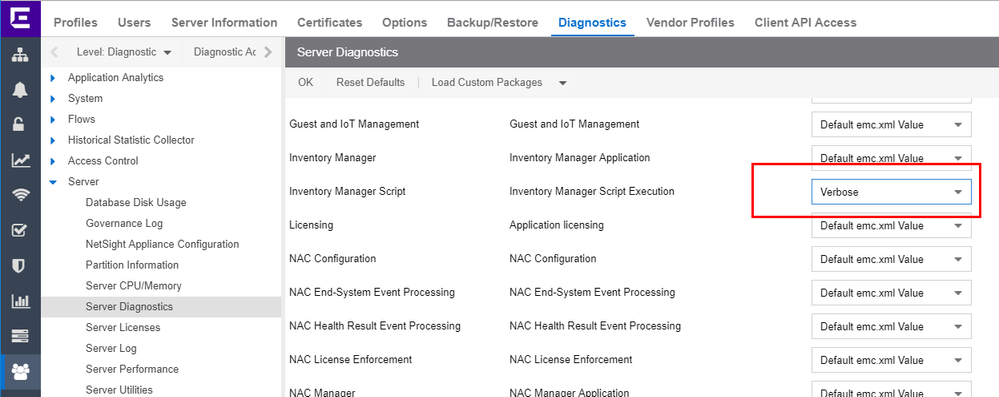

I guess then it is a timing issue.
Option 1 = change to Telnet and do tcpdump = you will see what is happening.
Option 2 = enable debug
Do not forget to pres OK and check the server.log then.

‎02-27-2019 07:42 PM
