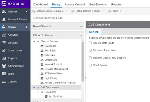

I've disable CoS in policy and did an enforce, well I think that's what I've done - see below:
dc1cd6a70a0a4a8daa65971985f76f89_RackMultipart20180704-8093-umogfu-Policy3_inline.png

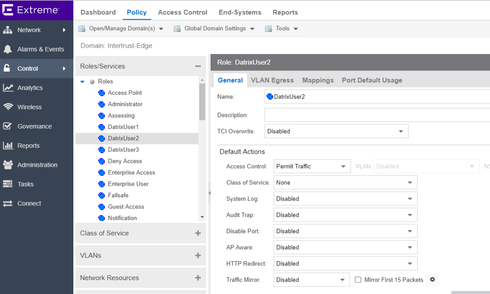

There are no TCi Overwrites configured and removed all the CoS settings, as can been seen in the screenshot below for one example I set the CoS to 'none'
20846cdcd91545919c6c67b2aed8ec7f_RackMultipart20180703-80788-7xn0as-Policy1_inline.png
But even after an enforce the cos value stays persistent in the policy configuration on the switch?
20846cdcd91545919c6c67b2aed8ec7f_RackMultipart20180703-67275-ph6mwc-Policy2_inline.png
So manually removed this but still no difference to amount of ACL slices used.
