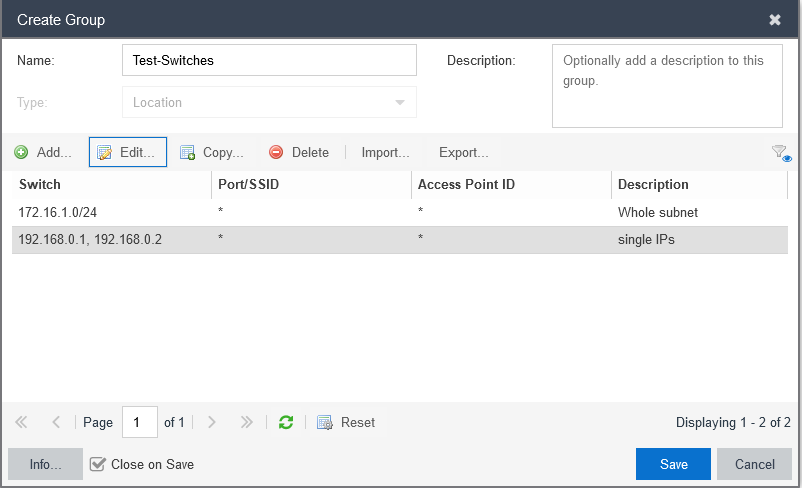

I have configured my X460-G2 switches to use NAC for management access.
I have 2 sets of switches and would like 1 AD group to manage any and another to manage just a subset.
The AD authentication and groups work fine. I have tried to set up a rule that uses the “End-System” criteria. I have created an End-System group based on the switch IP (I tried the MAC as well) but the switches IP doesn’t seem to be recognized.
I have RADIUS authentication and accounting enabled.
Is this the correct way to create different access for switches? If so what am I missing?
Is there a different rule I could create to accomplish this?
Thank you,
Chris

Hi Chris,
Use a location group instead of an end-system group and it will work fine.
The location groups can be used for:
Best regards
Stefan
03-16-2021 03:39 PM
Hi Stefan,
That worked exactly how I was hoping for.
Thank you for the help
Chris
