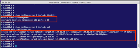

Ok, here's a screenshot of what it should look like on the CLI of the switch. The encrypted-auth is the encrypted password. If you already had most of it working with the script from XMC, you should just be able to change the VR on the first XML notification line.

Sadly, I'm still missing a piece of the puzzle. Figured out that the script that runs via XMC sets things up using VR-Mgmt, but we use VR-Default. Changed that setting and now the switches are connected to the server, but they aren't showing up in the "End Systems" section.
