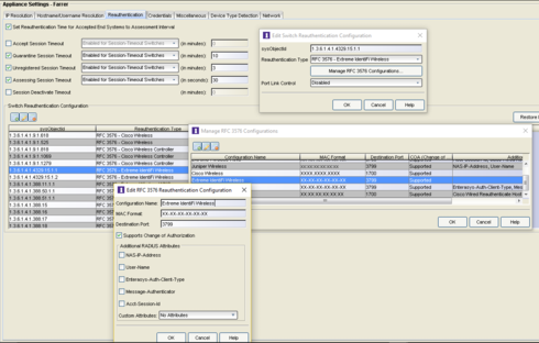

Below is a screenshot of what I believe is the configuration outlined above but it looks like CoA is already enabled?
6d8b0f99a36b439f8ffcd9dae57f12e2_RackMultipart20171008-99917-1la3to8-WirelessPolicy_inline.png

Hey Martin,
As long as the client's IP address doesn't change between Unregistered and Registered you may be able to use CoA and prevent any wireless disconnect.
In NAC Manager --> Tools --> Management and Configuration --> Advanced Configuration --> Global and Appliance Settings --> Appliance Settings --> Default
In the "Reauthentication" tab edit the Extreme Identifi Wireless RFC 3576 configuration and make sure "Supports Change of Authorization" is checked.
With CoA NAC will send a CoA request instead of a "Disconnect' request to the controller on registration and there should be a policy swap instead of a disconnect and subsequent re-authentication to get the new policy.
This mechanism doesn't work well in any scenario where the end-system IP address moves from one network to another. The policy swap will perform a dynamic policy swap, so if the client gets an IP address in VLAN A and moves to VLAN B the client will have the wrong IP address in the new VLAN. The "Disconnect" mechanism causes the end system to perform DHCP again.
