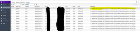

Troubleshooting DCS Events in a Identify WLAN Environment could be much easier if the DCS Events which comes from EWC into XMC would not only handle with AP Serialnumber and Frequency.
in many other EWC (internal) log files in meantime added also AP Name and Channel Number (e.g. RADAR). Which lead me much faster to the painpoint ...
Here the related EWC log message
(show via EWC CLI - for showing - you have to switch to the AP via serial which have the DCS event)
WLANController.XXX.XXX# show log ap 16230509485L0000 all
Msg: 05/29/18 23:31:07, Info, DCS Measured Noise -79dBm Exceeded Threshold of -80dBm on chann. 2472Mhz
Msg: 05/29/18 23:26:06, Info, DCS Measured Noise -79dBm Exceeded Threshold of -80dBm on chann. 2472Mhz
Msg: 05/29/18 23:21:06, Info, DCS Measured Noise -79dBm Exceeded Threshold of -80dBm on chann. 2472Mhz
Msg: 05/29/18 23:16:06, Info, DCS Measured Noise -79dBm Exceeded Threshold of -80dBm on chann. 2472Mhz
Msg: 05/29/18 23:11:06, Info, DCS Measured Noise -79dBm Exceeded Threshold of -80dBm on chann. 2472Mhz
Msg: 05/29/18 23:06:06, Info, DCS Measured Noise -79dBm Exceeded Threshold of -80dBm on chann. 2472Mhz
Msg: 05/29/18 23:01:06, Info, DCS Measured Noise -79dBm Exceeded Threshold of -80dBm on chann. 2472Mhz
Msg: 05/29/18 22:56:06, Info, DCS Measured Noise -79dBm Exceeded Threshold of -80dBm on chann. 2472Mhz
Is there a way that XMC can enhance this log message with AP Name ?? XMC have this information in database - but how can i trigger which mechanism to retrieve for the AP Serial also the AP Name ???
Unfortunaltey i guess expanding frequence number with corresponding WLAN channel number is not possible?! If yes, please let me know also.
I hope there is a solution.
Regards

It seem XMC have currently no solution, no possible workaround to achieve this !
Because it is a EWC deficiency i started a FR at the EWC group to enhance this.
RADAR Events are already sent in claimed manner.
Regards
