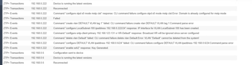

After many many hours working on it finally got to the bottom of the issue. The answer was starring me in the face and couldn't see it until GTAC pointed out the command above was trying to create a vlan called 'DEFAULT VLAN' were it should have been 'Default'
I think the error has come in due to the ZTP+ configuration were there is a button called 'Import VLANs' under the policy section:

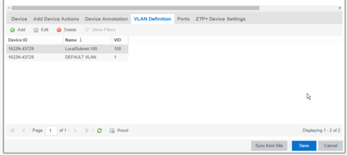

Here the default policy domain has been selected, although it could be any.
By default the following VLANs are part of policy. Although I had adjusted the VLANs in my policy to match the customers I hadn't touched the default vlan, mainly as you can't remove it even if you are not using it anyway:
As you can see the VLAN is called 'DEFAULT VLAN' and not 'Default' and why ZTP+ kept failing as it imported the wrong name!
In addition I was getting these errors:

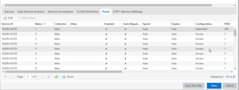

Command "configure port 52 auto on" failed: CLI command failure:configure port 52 auto on:Error: Speed has to be specified on port 52
So you need to make sure the ports are disabled for auto and fixed, which you can do once the device as been discovered an waiting pre-configuration. You just go to the ports tab and set it.
Once staged just manually reboot the switch (you can wait but you'll be waiting a while) then it should pop into EMC without issue.
