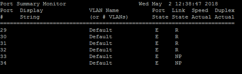

‎05-02-2018 11:30 AM
It is running 21.1.4.4 patch1-6. I think I have the problem partially figured out. Looking at the logs on the server, I do see the messages below about configuring certain ports. I went ahead and hard set 29-32 at 10 gig since that is all that can be installed in those ports, and the errors regarding those ports went away. But what are ports 33 and 34 on a X460G2-24t-10G4?
2018-05-02 08:58:21,823 ERROR [com.enterasys.netsight.server.webapps.monitor.ezConfig.MsgDispatcher] ZTP+ configuration failure for device : 1750N
2018-05-02 09:01:48,939 ERROR [com.enterasys.netsight.server.webapps.monitor.ezConfig.MsgDispatcher] ZTP+ event : 1750N : CLI : Command "configure port 29 auto on" failed: CLI command failure:configure port 29 auto on:Error: Speed has to be specified on port 29
2018-05-02 09:01:48,939 ERROR [com.enterasys.netsight.server.webapps.monitor.ezConfig.MsgDispatcher] ZTP+ event : 1750N : CLI : Command "configure port 30 auto on" failed: CLI command failure:configure port 30 auto on:Error: Speed has to be specified on port 30
2018-05-02 09:01:48,939 ERROR [com.enterasys.netsight.server.webapps.monitor.ezConfig.MsgDispatcher] ZTP+ event : 1750N : CLI : Command "configure port 31 auto on" failed: CLI command failure:configure port 31 auto on:Error: Speed has to be specified on port 31
2018-05-02 09:01:48,939 ERROR [com.enterasys.netsight.server.webapps.monitor.ezConfig.MsgDispatcher] ZTP+ event : 1750N : CLI : Command "configure port 32 auto on" failed: CLI command failure:configure port 32 auto on:Error: Speed has to be specified on port 32
2018-05-02 09:01:48,939 ERROR [com.enterasys.netsight.server.webapps.monitor.ezConfig.MsgDispatcher] ZTP+ event : 1750N : CLI : Command "configure port 33 auto on" failed: CLI command failure:configure port 33 auto on:Error: Speed has to be specified on port 33
2018-05-02 09:01:48,940 ERROR [com.enterasys.netsight.server.webapps.monitor.ezConfig.MsgDispatcher] ZTP+ event : 1750N : CLI : Command "configure port 34 auto on" failed: CLI command failure:configure port 34 auto on:Error: Speed has to be specified on port 34

‎05-02-2018 05:41 AM
Can you enable the logs on ZTP+ to Verbose (XMC side) and paste the relevant part, so that we see the exact issue?
Eventually, if you can access the switch, there's a cc_logs directory on the switch. The files in it can be useful to troubleshoot.
Edit: btw, what EXOS version on the switch?
