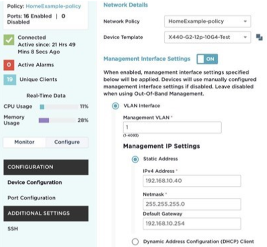

XIQ was patched on 2/10/21 with added support for EXOS management interface settings!
Management Interface Settings can now be enabled for EXOS in policy switch templates. Within EXOS templates, DHCP client can be enabled for VLAN specified.
Management interface settings can also be enabled in the device level configuration. When enabled at the device level, a static IP, subnet mask, and GW can be defined for a specified VLAN.
Existing EXOS devices onboarded to XIQ will continue to use manually configured management interface settings if template and device level management interface settings are set to disabled (which is the default setting).
IMPORTANT: Management interface settings for EXOS should be set to disabled when using EXOS Out-Of-Band Management interface.

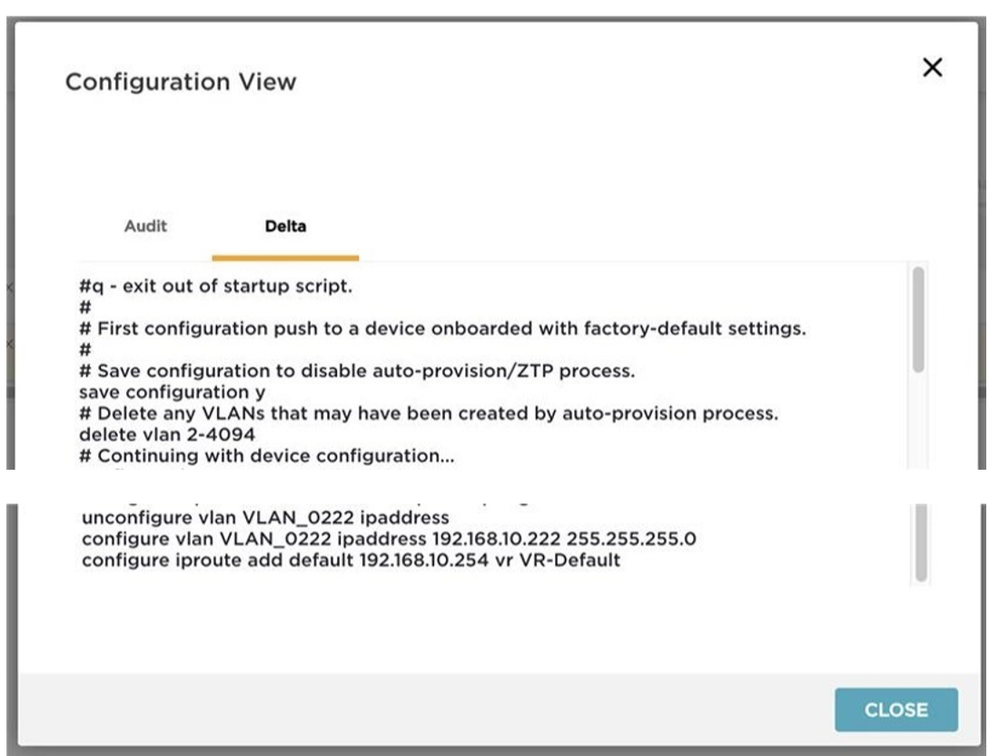

NOTE:: If an EXOS switch is onboarded in a default state, XIQ will also bypass the EXOS CLI startup menu script during the first delta configuration update. EXOS auto-provision feature be cleaned up if a default switch also has Interface Management Settings enabled at the template or device level configuration.
Here is an example of a default switch delta push with management settings enabled at device level with static IP and GW defined on VLAN 222:
