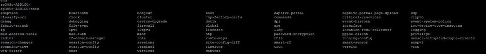

@Ash Finch ; i don't have the option ā€˜show capwap client’ while i'm connected with SSH.
i only have these options:
