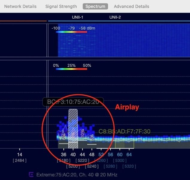

what i forgot to mention the Apple Ad-Hoc network uses the following channels:
6
44
149
a_huerzeler
Contributor
@jayotte Hi i found out a few things about the behaviour of Apple TV in the past. The most comprehensive document about how Apple TV actually behave in the network can be found here:
https://arxiv.org/pdf/1808.03156.pdf
What I learned is this: the Apple TVs will always generate an ad-hoc network and not use the existing wireless infrastructure as long as the wifi channel is less than 80 MHz wide (which will always be the case in business and education). If the existing Wifi is on 40 MHz channels the adhoc network (AWDL Apple Wireless Direct Link) will create also an 40 MHz wide Adhoc wifi, if you use 20 MHz it will create an 80 MHz wide Ad-hoc wifi.
To my knowledge today there is no way to force an Apple TV to use the existing wireless infrastruction.
Best
Andi
