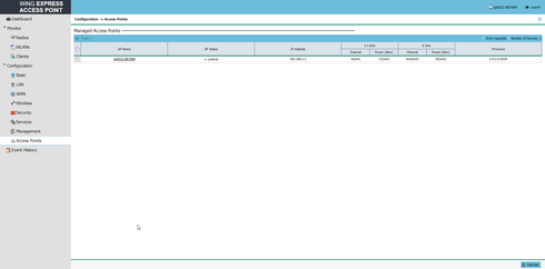

HOLA
NO PERMITE CONFIGURAR CANAL Y POTENCIA.
NO MUESTRA SSID CONFIGURADO.
EL MISMO PROBLEMA ESTƁ PASANDO EN VARIAS CUENTAS. ANTES SE PODƍA REALIZAR CONFIGURACIONES POR AP.
ĀæHAY ALGUNA ACTUALIZACIƓN QUE DEBE HACERSE?
FIRMWARE AP ACTUAL 10.3.3 Y 10.3.4

Ronald_Dvorak
Honored Contributor
Hi Dany,
the thing that I've never seen in my setup is that the radio mode field shows "no change".
Could you try another radio profile from the pull down menu and save/update the AP configuration.
It like to see whether that changes anything.
In regards to the SSID > is one configured on the network profile for that AP ?!
-Ron
here my AP...
hi ronald
I have changed the radio profile and "RADIO MODE" does not show anything.
The AP has a template that broadcasts SSID: "home" and there are currently 01 devices connected.
The changes are saved, the radio profile is updated and returned: RADIO_g0
Radio mode: without showing anything.
When making a change, it does not show channel and power, I have to restore the default to show channel and power again.
