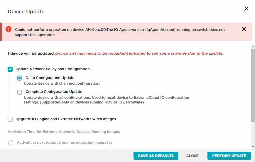

Hi All,
When we try to update new devices on HMOL we’re getting error:
Could not perform operation on device AH-9eac00.The IQ Agent version {iqAgentVersion} running on switch does not support this operation.”
This is on both a new ap150W and ap130 which hasn’t previously been onboarded.
Any ideas?
Thanks
Jona

Thank you for adding me to your XIQ instance. I ran this past a few XIQ technicians and they agree we’d need a case here. If you can let me know your case number once you’ve filed a case, I can update the case with my notes so they know what we’ve covered so far. I’m sorry I couldn’t be more helpful here.

Just to add to this, I think this is related to change in how the version is reported, see screenshot - device highlighted in red is broken with the error above, device in blue is fine.

They’re on 10.0.10.2 and 10.0.8.0, I’ve attached a screenshot below.

Hi Jona, what firmware version are your devices on currently? We’d need to be on 6.5r3 or higher to manage the device in HMOL (a.k.a. XIQ).
