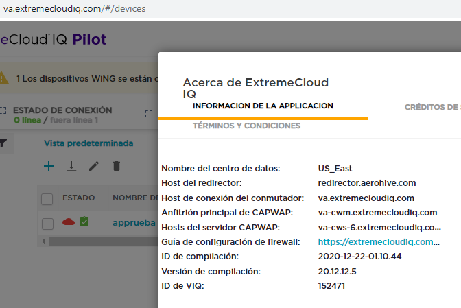

which server is correct ?, with the previous question
current version AP 7.3.0.2-011R

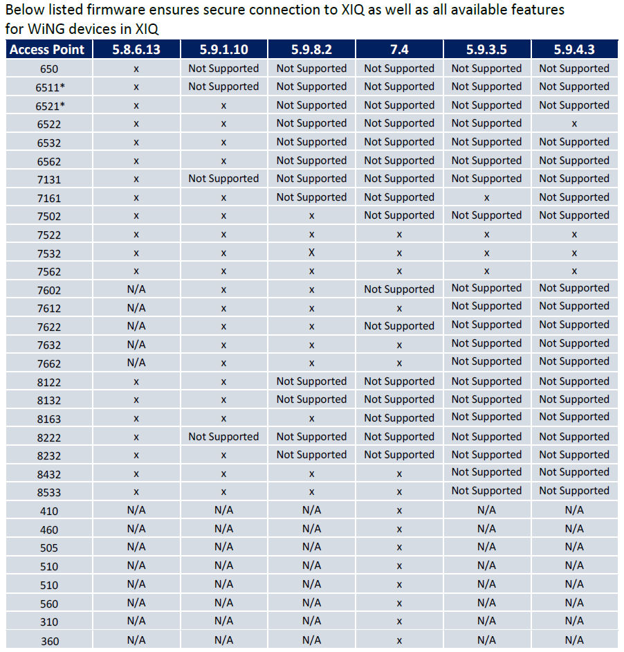

What's the firmware version on your AP7532? You should either have the latest 7.5.x release, if not, then one of the following versions:
Aside from the firmware, check your nsight policy configiration as well, looks like you have two different lines under your nsight policy one of which (marked RED) is wrong.
nsight-policy XIQ server host va-wing.extremecloudiq.com https server host va.extremecloudiq.com https
