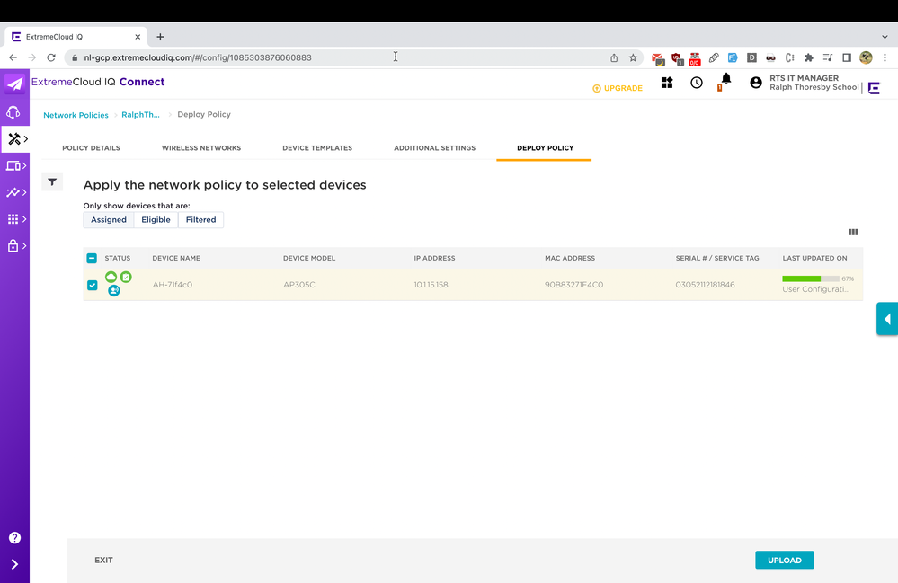

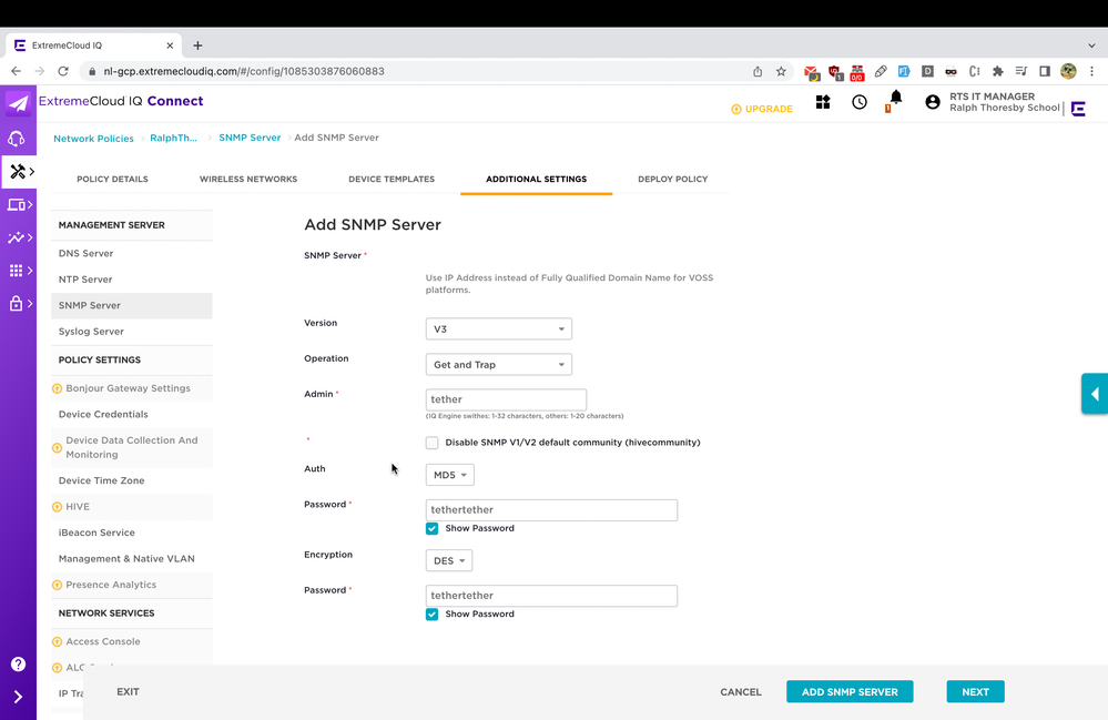

Here are some screenshots of my setup:
I have created a non-default device template to enable SNMP as described in the howto manual that I mentioned above. Here is a screenshot of Manage > Devices > Edit > Configure > Interface Settings
Custom interface template:
Traffic filter in Network Policy > Additional Settings enabled and set to enable SNMP
Device info:
SNMP settings v3 (I also tried v2, same results)
I made sure to apply the configuration and wait for the access point to reboot:
