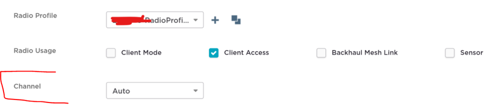

Hello!

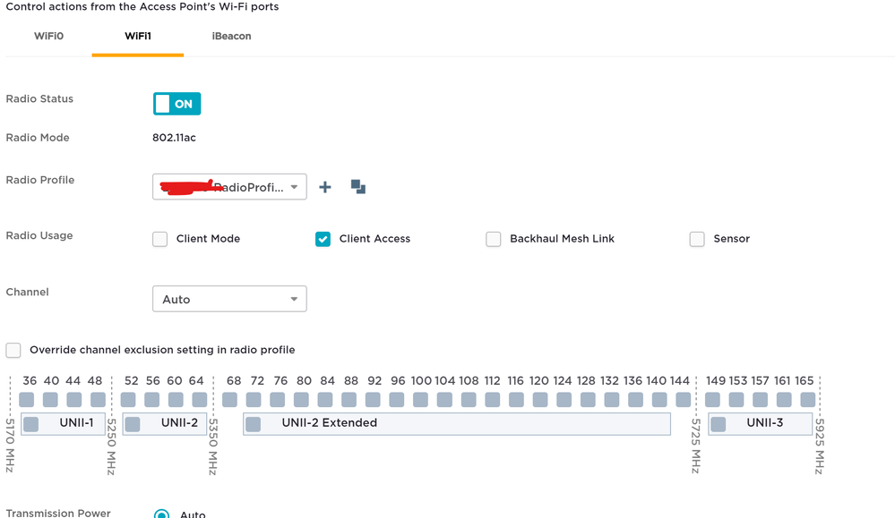

I'm new to this platform and we are trying to test if a specific channel works with one of our devices. We decided to use an isolated room that isn't in use and change the radio settings on that room's AP. I selected the AP and went to wireless interfaces, and there is a drop down menu for the radio profiles. If I create a new radio profile with only the selected channel and then select that profile from the dropdown menu for that AP, it should ONLY apply to that AP, correct? I am just concerned as I don't want to make a change that is global when I'm just trying to test something on one AP. To be clear, I am not making changes to the Device Templates.
Another thought is if I can just press Override Channel exclusion settings in radio profile? Will that allow me to manipulate channel selection on this AP only?
Thank you for any clarification!
‎11-01-2021 06:50 AM
​Yes, any changes applied under Device level Configuration section apply to only that specific device (Manage --- Devices --(click on Hostname of Device)).
If you want to set a specific static channels for WIFI0 or WIFI1 Interface, you can chose that Channel from drop down menu:
If you do not see desired channel under above drop down, you would need to create a new Radio Profile (as you intended to do).
