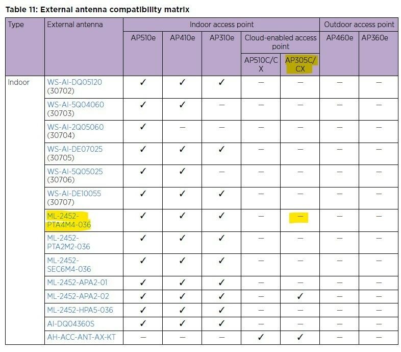

Hi, one of our customer wants to use the antenna ML-2452-
PTA4M4-036 with AP305CX, but in the latest antenna guide for wifi 6 AP of October 2020 that I’ve downloaded from the Extreme’s site, in the following table says that is not compatible:
May it works anyway?
Thanks

SamPirok
It will not work correctly, that antenna is not compatible with the AP305CX.

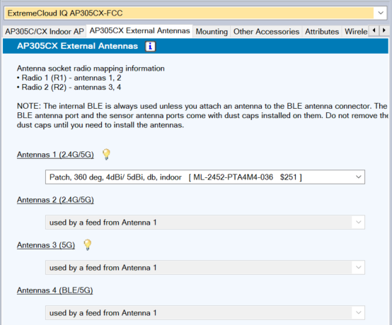

pzastrow
Well, in hindsight we know now it will definitely work with the AP305CX. See below.

pzastrow
SamPirok
