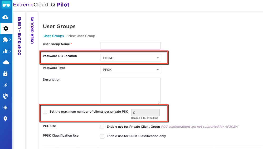

Is there a way to change the password db location from cloud to local w/o deleting the group?
04-07-2021 08:16 PM
If you set the user group to use a local Password DB Location (meaning the user credentials are stored on the AP instead of the cloud), then you’ll see an option in the user group to set the maximum number of clients per private PSK. If you’re using a cloud based Password DB Location, you won’t see that setting in the user group and would use the setting in the SSID instead.
