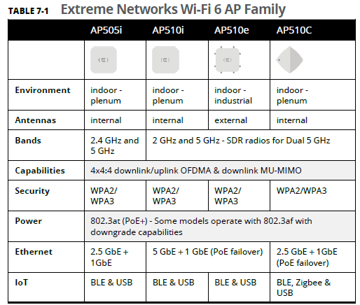

09-21-2021 09:55 AM
Hi Stefan, Andre,
I was considering if it actually supports UL MU-MIMO as it’s an 11ax AP and UL MU-MIMO is part of 11ax. I wouldn’t promote that feature btw. 😉 But you are right on this, in the “Wi-Fi 6 for dummies” by Dave Coleman I could find a note that uplink MU-MIMO is not there on 1st gen 11ax APs, and there’s such sheet for final clarification, mind the ‘Capabilities’ row:
