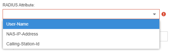

As of 8.5.3 ExtremeControl has the ability to use multiple RADIUS certificates using EAP Group Mappings.
The determination of those certificates is done using EAP Group Mappings via the exchange of RADIUS packets to look at User-Name, NAS-IP-Address (Switch IP) or Calling-station-id (MAC Address), as per below:
You can then use a POSIX regular expression to find a match:

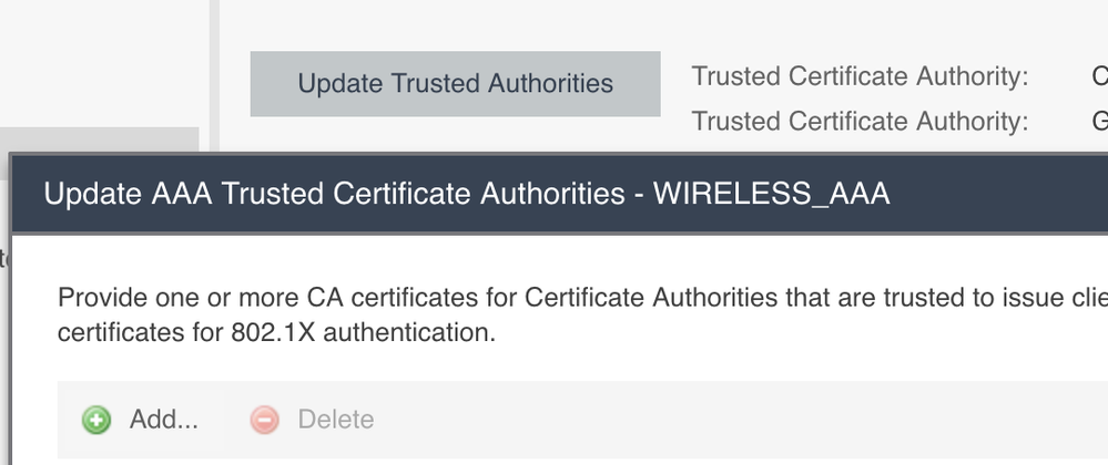

Concerning the AAA, yes you ca upload both Root CA and the RADIUS will choose the one corresponding to the client certificate.

In regards to AAA configuration, which is used to validate the client certificate / authentication, do you know if I can install root and intermediate certs for each of the PKI's in the same place?
That way the client certificate presented to NAC will be able to chain automatically against the right ones?

The EAP Group Mapping will define which certificate will be presented by the RADIUS server based on the Username/NAS-IP/MAC.

I the check the Usernames like "host/computername.private-domain.local" for computer authentication and the via the EAP Group I check the username and I present a RADIUS certificate that was issued by a Root-CA available on the specific computer.
