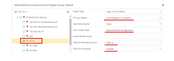

Hello,
I understand that it is possible to create a network policy in Cloud IQ for Wireless which can use External RADIUS server for authentication (Extreme A3, NPS, Extreme Control). Do the APs (AP3705C) which are onboarded in the cloud also need to be added under Access-Control>Switches? If so what RADIUS Attributes should they use?

Hello Robert,
That is a great document that was developed by our TME team. I use it myself all the time.
To answer your questions for future use:
The AP's needed to be added into the Control --> Switches tab.
Extreme Control/A3 both can have local users or integration with AD.
Thanks
-Ryan
Adding APs into the Control switches tab will add them to a clients.conf file that will make them authorized for RADIUS communication. Without them in the clients.conf file NAC will not respond to RADIUS requests from their IP address.
We use filter-ID for role assignment with XIQ.
