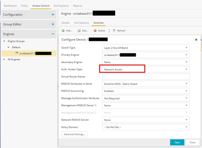

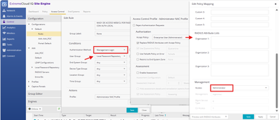

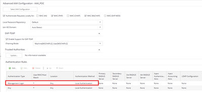

‎05-15-2025 04:26 AM
Hi Rien,
I did this lab and works for me.
I did local auth:
Rule
Swicth, I use "Network Access" because for EAP/NEAP test.
Cheers!!
EF
‎05-29-2025 05:46 AM
Auth Access Type is worgn set it to "management Access" sorry.
