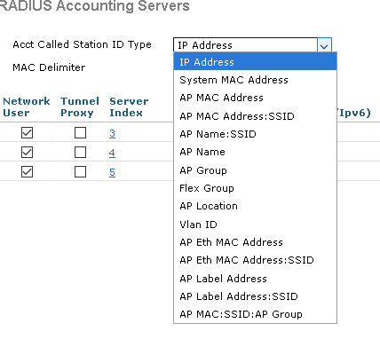

tfsnetman
Contributor
Hi guys,
Accounting Called Station ID type is set o IP and there is no option for both MAC and IP - see attachment.
We are talking about Wi-Fi and 802.1x authentication only where IP addresses are always assigned via DHCP.
@Stephan: not sure whether what you mean by registering NACs as a DHCP server and how those DHCP requests would flow.
Thank you,
Klaus
StephanH
Valued Contributor III
Switching on WLC accounting is not always sufficient depending on the sw version. To be sure you have to check if the transmission of MAC and IP under
Acct Called Station ID Type
is switched on. But guessing helps little here, it would be good to know how the address resolution runs in the installation Klaus mentioned.
Regards Stephan
