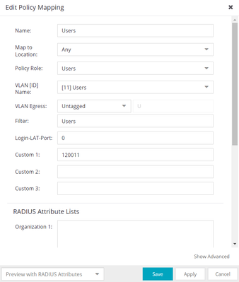

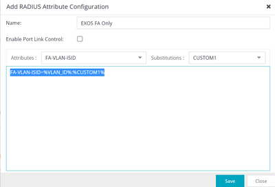

Just use proper radius attribute
Attach new "Radius attributes to send" config to EXOS switch.
Then in NAC Profile add ISID number to Custom1 field:
Of course you can remove ISID from Policy config and still use Policy with conjunction to FA (eg. for traffic filtering)

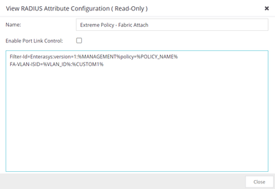

Policy with control "Permit" and VLAN Egress definitions for tagged vlans only.
NAC would respond with Policy name with Filter-ID and FA-VLAN-ISID for untagged traffic.
Example:
Filter-Id=Enterasys:version=1:policy=ACCESS-POINT
FA-VLAN-ISID=11:120011
ACCESS-POINT Policy profile includes "Permit" permission and only "tagged" VLANs (in VLAN Egress tab in Policy Manager)
FA-VLAN-ISID would set up untagged vlan 11 and i-sid 120011
