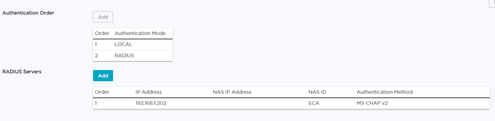

I set it up using XCC controller using MS-CHAPV2 authentication:

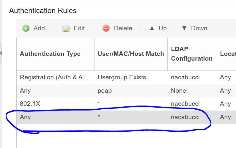

Make sure your Control AAA configuration has a line to handle either "Management" auth type or "*":

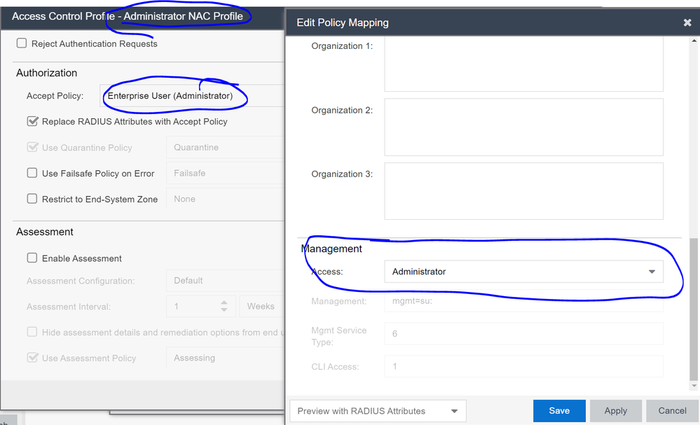

Then make sure there is a rule that provides the correct authorization string for management access:

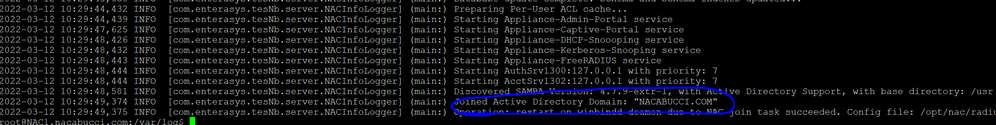

When you set the AAA line up for "LDAP Authentication" NAC should attempt to join the domain controller on enforce, it will also attempt to join on services restart:
You can check the /var/log/tag.log to see if there was a domain join failure or success:

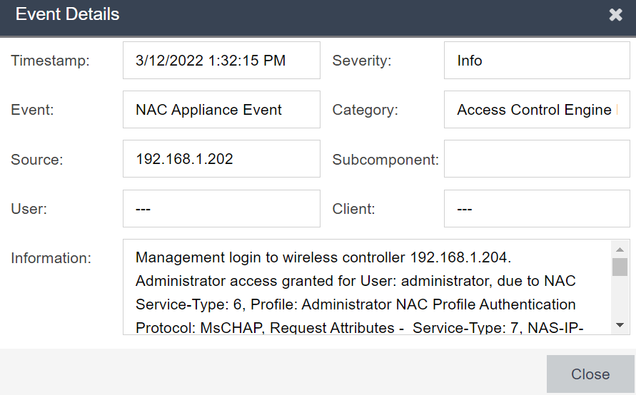

You can check the status of the management login if you go to Alarms/Events  --> Type Access Control/NAC
